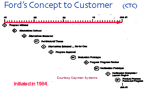

Ford's Early Take on APQP circa the 1980's

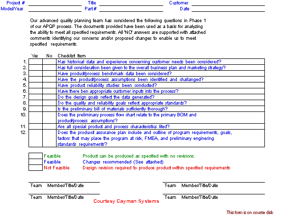

APQP Phase 1
Plan & Define Program

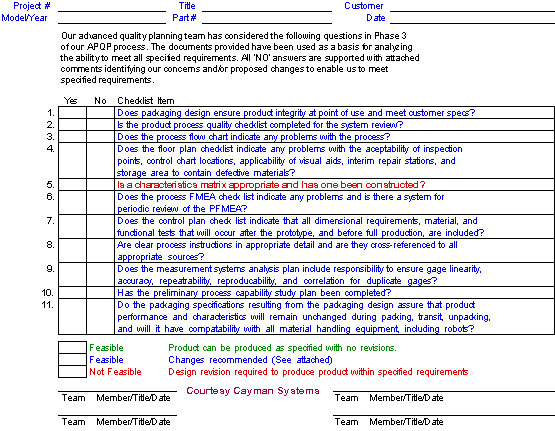

APQP Phase 3
Process Design & Development Verification

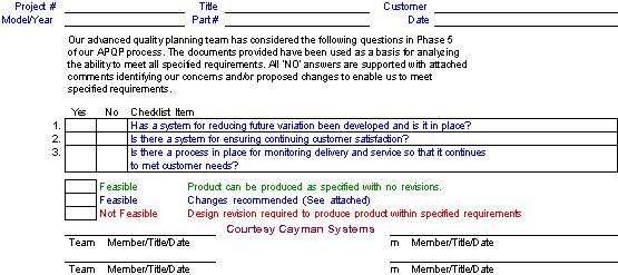

APQP Phase 5
Feedback Assessment & Corrective Action

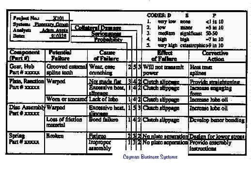

An Early Process FMEA
Circa 1965?
